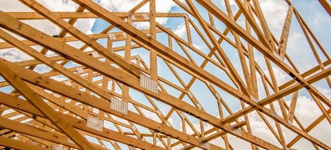

2. Check the Timbers
Once your roof is clear of the asphalt shingles or whatever covering it had, you will need to check the roofing timbers and replace any that look at all suspect. In most cases, the roofing timber should be fine as it is usually the actual roofing sheets that need replacing. However, if in doubt about any particular timber, it is best to replace it now.

Each shingle needs to be nailed into place and has to be straight. Attaching them with an air gun is a lot faster than a hammer and nails. If you’re doing the garage roof replacement with roof sheeting, it is a lot easier, but you will require at least 2 people to get the sheets into place. Remember that if you do not have a head for heights, this is not a job for you to tackle. You will be standing on open trusses, some of which are way up in the air.
