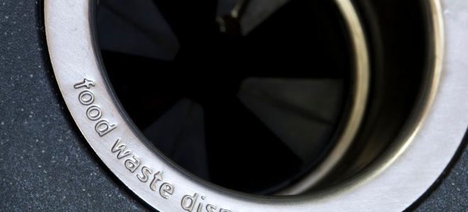

garbage disposal in a sink

Jammed Disposal Unit
loosening a connection on a garbage disposal
The disposal is switched on and it is humming but the blades do not work. If this is the case, it means the disposal is jammed. Turn off the power at the electric panel and unplug the unit. Use a dowel or tongs to dislodge whatever is blocking. Never use your hand to pry anything that is inside the flywheel. Use a wrench to turn the flywheel. Try to move the impellers back and forth until they move easily. You may have to remove the unit to adequately clean it. Run water to clean the loosened particles and slowly spin the flywheel. Once there is smooth movement, plug it on and turn on the circuit breaker and switch on to use it.
