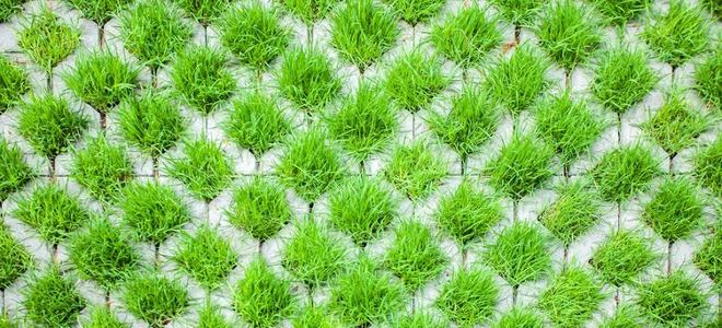

What Is Grasscrete?
Grasscrete incorporates a mixture of concrete and natural soil in a patterned layout. The mixture is generally about 47 percent concrete and 53 percent holes for the grass. Over time, the grass will eventually grow over the concrete and conceal it in areas of low traffic. This green alternative might seem strange at first, but there are actually a lot of benefits to using grasscrete over concrete.

Installing Grasscrete
With so many benefits, it’s easy to understand why so many people are switching to grasscrete. Fortunately, installing a grasscrete driveway or walkway is an easy process that just takes some time and effort.

Step 4 - Grass Forms
With the crushed rock and sand mixture in place, you can install the grass forms. Begin with the edge work before working your way up from the bottom. Follow the manufacturer’s instructions and make sure everything fits correctly before cutting some of the forms to fit in place.
Step 5 - Top Soil
After all the forms are installed, pour a few layers of top soil over the driveway. You want the top soil to fill in the gaps between the forms and don’t stop until the soil is at the same height as the forms. You can also seed the top soil with grass to help with new growth.
