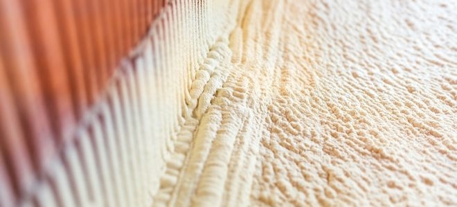

Icynene
This is a strong, durable insulation material, which is sold in the form of spray-in foam cans. Unlike other foams, Icynene does not produce any off-gasses. Its main disadvantage is the price—it is 3 to 4 times more expensive than the regular fiberglass. Moreover, because it is water-blown, Icynene must be installed by a professional, which further raises its cost.
