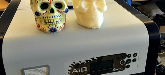

The first thing we scanned was a figurine of a hula girl we stole from someone’s desk (you know who you are). Her extended arms were too fine for the scanner to read properly and they came out as fuzzy, digital noise in the rendering, so we didn’t try to print her. Next we scanned a Dia de los Muertos skull candle and after recalibrating the scanner (jostled in shipping) got much better results, but still with some noise.
Here’s What We Think of Our 3D Printer, scan, Justin DiPego
The recalibration did not improve the scan of the hula girl, revealing the limitations of the application. If your object is smaller than 2 inches square the scanner can’t accurately capture it. On the other end, the area of the print bed is about 10 inches square, but the footprint of the skull candle was less than 6 inches. The chin and the back of the head were at the extreme ends of the scan window. So, if you want to scan something, it needs to be larger than 2 inches and smaller than 6.

If you're new to the process (like us) this leads to a learning curve a little steeper than it should be. But, that was just a learning curve and not a technical problem. The skull printed nicely, including exact replication of the digital noise around the eyes.
Here’s What We Think of Our 3D Printer, scan, skull, dia de los muertos, Justin DiPego
