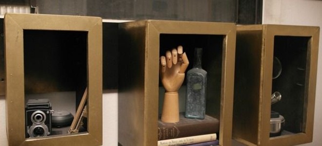

Once everything was dry, I got to be artistic with a can of gold spray paint. I deliberately didn’t want to have clean lines and used overspray to create a burnished look.
Just the face and front edges of the boxes got the gold. For continuity, I hit the corners of the ledger board with the gold as well.

With the ledger board in place, it was just a matter of first choosing the best arrangement of the boxes, then using the already drilled pocket holes to mount them. I didn’t use glue here, thus leaving myself open to rearrange the boxes some time in the future. The most important part of hanging the boxes was making sure their tops were even with the top of the ledger board and the windowsill.
In a way, the endeavor was just as much about building the furniture as its final usefulness. It was an opportunity to be both logical and creative.
Once the piece was up, my wife found various objects from around the office to fill the shadow boxes. Ultimately, the project was the perfect blend: a functional space that was also aesthetically pleasing.
