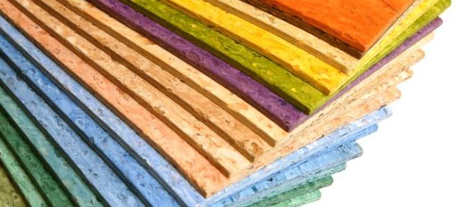

We decided to put vinyl self-adhesive tiles over the old linoleum floor in our small kitchen. After thoroughly cleaning it and laying the new tiles on the floor for a test run, it didn't work with the cabinets, so we decided to get new tiles from the big box store yesterday. My wife is on my case wanting to finally finish the kitchen, threatening all sorts of things, however, I know there is a 48 hour wait period for the tiles to acclimate with our home's temperature. Since the temperature in the big box store is around 65-70, in our home is about 70, should I wait the entire 48 hours anyway, or should I spend the holiday laying out tiles to make the wife happy?

Acclimation is not just a temperature thing, it is a humidity issue as well. Basically the flooring has to "come into harmony" with the environment it lives in. Wait the whole 48 hours.

With the poor track record of the P&S tiles, I would wait the 48 hours and follow the manufacture’s directions to the letter. That way you will have the best chance of success and longest life of the flooring.
Tell the boss your hands are tied because of the manufactures instructions, and if she protests, ask her if she wants the flooring to last or not.
