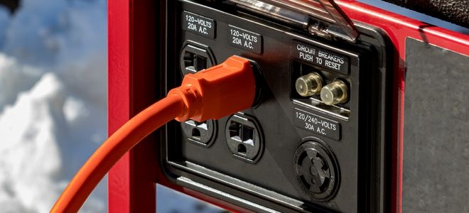

Tens of thousands of people purchased gas generators after Sandy. Some ran extension cords through their home, others questionably wired them into their main panels. Now that things are (hopefully) getting back to normal, now's the time to prepare for the next time you need the generator to ensure it's setup safely and legally.
There are a few options, but first, the things not to do:
DO NOT use a cheater cord (aka suicide cord). This is a hacked-up extension cord with two male ends. It's an electrocution hazard and can easily feed electricity back into the grid, both which are bad things.
DO NOT directly connect the generator to your main panel without a transfer switch or interlock. You may remember to turn off the main breaker before energizing the generator, but if you happen to forget that once, or someone else in your family does the setup, the results can be disastrous. Linemen working on fixing the lines can be electrocuted and generators have been known to short out or explode if connected when the main power comes back on.
Option 1:
Use extension cords. Simply get a number of extension cords for your fridge, lamps, and other required appliances. Your standard 16ga extension cord will be fine for anything other than window AC units or space heaters. For those, you'll need headvy duty, 12ga extension cords. The lighter duty ones can easily overheat. The downside of this option is that any hard-wired appliance (heat, well pump, etc) won't work. No permit is required.
Option 2:
Use a transfer switch. These can be purchased for $150-$300+ and will allow a certain number (4/6/8/12) circuits to be switched between mains and generator power. It will be wired next to your main panel and you'll pick the most important circuits to be switched. Add an inlet and a twist-lock extension cord and you will have a professional installation. A permit and inspection is required in most areas.
Option 3:
Main breaker interlock. Some, but not all, main panels have interlock kits which are a mechanical plate and other pieces that allow either the main breaker OR the generator breaker to be on. There are also some after-market interlock kits which are UL tested but may or may not be accepted by your local inspector. The best course of action is to print out the details and ask your inspector before buying the hardware. If approved, this method allows any combination of circuits to be run by the generator, limited of course by the wattage of the generator. Again, a permit is required in most areas.
Option 1.5:
If you're not ready for a full transfer switch, you can get a one-circuit transfer switch for a gas furnace. You'll still use extension cords, but it's a code-legal way of attaching a fixed appliance. There are multiple options out there, but here's an example: Reliance TF151W Single Circuit Manual Transfer Switch 15 Amp
Other generator reminders:
Be sure to run your generator away from any habitable structure. Generators exhaust carbon monoxide and can easily seep into windows. Many municipalities recommend a 20' separation between the generator and any habitable structure.
Be sure the generator is exhausting somewhere safe. Not against wood or vinyl siding, dry leaves, dry grass, etc. The exhaust is HOT!
Gasoline goes 'stale' after 6-12 months. Either rotate your gas (use it in your car before then) or use a stabilizer such as Sta-Bil. You will still want to rotate your gas every 12-18 months even with a stabilizer. Also don't forget to stabilize or drain the gas in the generator tank. Either drain the gas and run the generator until it runs out, or use a stabilizer in the fuel tank and run the generator for 5 minutes to circulate the gas. If you don't, you may find the carburetor clogged in a year or two when you need it most!
Start up the generator every month or two and let it run for a few minutes.
