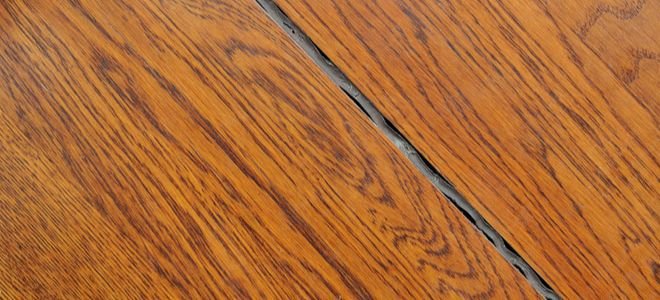

I have a 1905 house in Boston with hardwood floors which have large cracks in them that were filled many years ago. In many areas the filling looks pretty good however over the years the filling in some areas had is cracked and crumbled away. I decided to refill some of these areas and have dug out the filler. I'm wondering what would be the best choice for filling these areas given that it is in fairly high-traffic areas. To make things worse, the floor boards are not entirely stable in the affected areas which surely explains the old wood filler cracking. I realize that probably the better option is to remove all the flooring and replace it however that is not financially feasible.

Is the gap only a 1/4" deep or is that all you are concerned about filling?
With gaps that wide, I'd consider ripping strips of wood to fill the void.

That is a good idea although the spaces are somewhat irregular. The spaces are about 3/8 to 1/4 inch deep and I plan to fill them entirely. I suppose I could rip something to fill most of it and do the rest with wood filler of some sort. Looks like pine right?
Below is what I am dealing with and what I have already for possible fillers. One picture shows damage that must have happened before the steam radiators were repaired as the area has always been dry on my watch. The Stain pen matches the other areas that have been filled. My plan as it stands is to fill the gap, sand it, use the stain pen and then put some finish over it.

IMO anything that reduces the need for more filler is a good idea. I wonder if taking a skilsaw along with a straight edge [fence] for a guide would allow you to put in a straight filler piece without as much filler.
Looks like pine to me.

Mark is suggesting replacing the wood—using a filler piece of wood in the gap and using the saw to create straight lines so installing the new piece is easier.
marksr - Forum Topic Moderator
That's correct, make the gap even so a ripped piece of pine can easily be set in place. Set your saw blade depth at the same thickness as the flooring so you don't cut into the floor joist. Some of your gaps are really too wide to be a good candidate for filler. Inserting wood more or less guarantees that the filler won't fail [if still needed] and will look better than just using filler.
