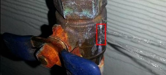

My girlfriend and I just bought our first house and our HOA has sent us a welcome letter with a warning about our crappy lawn... It wasn't very welcoming. As such, I decided to get the sprinkler system going tonight. After turning on the water at the valve in the crawlspace, I went to the Pressure Vacuum Breaker to turn the water on there. Forgive my misuse or ignorance to sprinkler system terminology if I use the wrong words. Anyway... I opened the valve on the house-side of the PVB. It leaks a little, but nothing a little plumbing tape wouldn't fix (correct me if I'm wrong). Next I opened the valve on the sprinkler/yard-side of the PVB and I got a lot of spraying from a crack in the body of the valve. In the images below, the crack is outlined by a red rectangle. The PVB itself appears to not have any problems though.

Obviously I need to replace that valve/valve-body, but I'm wondering if I can replace JUST that or do I need to buy an entire PVB assembly, valves and all?

If everything else is working and not leaking I would just replace the one cracked valve. I'm sure the next question will be "how do I unscrew it?" I guess they assembled the threaded fittings then glued the assembly onto the PVC pipes coming up from the ground. You can cut both PVC pipes (make sure the main water is turned off), replace the bad valve then reconnect the PVC with glued couplings or union fittings.

They are 1/4 turn ball valves or just "ball valve." Yours have female NPT on both ends. On the bottom side there is a male NPT to PVC slip fitting. On the top of the valve there is a pipe nipple connecting it to the backflow preventer.
When you unscrew the broken valve you've got a 50/50 chance that the pipe nipple will stay in the valve or the backflow preventer. If it comes out with the valve it will be difficult to remove without messing up the threads so I'd just buy another one (pipe nipple). They are usually less than a dollar.

Thanks Pilot Dane. I was able to replace it without any issues. I appreciate your assistance with all this.
