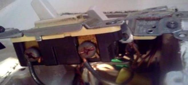

Thanks everyone for your responses. I'd like to highlight something just to make sure it is not being overlooked. The wires that I am planning to cap in a handy box (which are currently connected to my garbage disposal) are on the same circuit as an overhead light that I still use. The light and garbage disposal are connected to separate single pole switches, and both switches are located in the same box.
Here’s my follow-up question: If I cap the wires that are currently going to my garbage disposal, will doing so cause a short or other potential problem because the circuit is no longer complete? It seems to me that capping the wires (so that the ends of the black and white wires have wire nuts but are not connected to anything else) might break the circuit (?) As you can see, my understanding of electricity/circuits is rudimentary at best, so please excuse my ignorance.
Thanks again.
Gunguy45 Super Moderator
Think of it this way... when the disposer is off, does the light work? I'm sure it does. All you are doing is basically turning the disposer off permanently.
Looking in the back of your picture... I see 3 whites tied together? Bet there is also a nut with one black coming from outside the box and 2 blacks leading to each of the switches?
Likely the feed has been brought in, then split to feed each switch.
No problem... cap 'em!
