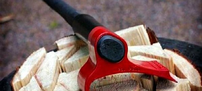

Invented about 5.5 million years ago the axe took a great leap forward when someone invented the axe handle around 6000 BC. Since then, improvements have been slow, so if you’ve got a lot of wood to chop, particularly if you’re splitting logs, maybe this radical, half winged new design could be your answer. The Forum weighs in. (Regardless of the axe, love the tire.)

Whaddya think Ray... really dry wood? Pretty cool idea... a little pricey at almost $300.
I like the tire idea though. I use a maul and am used to chasing my wood around the backyard. This way I build up lower and upper body strength.

The axe edge has a wedge built in. And the other end has a stop so the axe don’t go in the wood all the way and get stuck. Also goes in at an angle and wedges the wood as it cuts...

Personally I wouldn't split firewood into chunks that small. It will burn up too fast. Once the fire is going good I like to stuff some fat logs in the stove and forget about it. While splitting wood inside the tire looks neat I suspect it's more hassle than it's worth. I'd like to see some of my firewood split that quick before I'd be sold on the design - I think it's more the wood than the ax.

A relative of mine who lives overseas saw this and was ready to buy it. However, after investigating here is his quote.
"I actually looked at this last week and looked to buy it. According to Popular Mechanics review, it works well for Scandinavian wood... straight grained, birch, beech, pine... not so good on oak, maple etc. So I think I will pass unless we live where I can get a steady supply of straight grained wood."

The wood that guy's cutting looks like it would split if you frowned at it.
Just curious but wouldn't the torquing of the handle wrench your wrist a little upon impact?

I have some hard maple that has grown out in the open that the grain is so twisted you can almost screw it into the ground. I also have seasoned black locust, elm and beech that even a wood splitter stalled out on. That wood looks almost like cotton wood. I can split that with an axe without any problems. If you know how to split wood with an axe you know just as the axe strikes the wood you twist the handle slightly to keep the head from sticking in the wood.

I hate hitting a knot and the axe head twists in my hands. I don't think I would like an axe DESIGNED to rotate in my hands.
