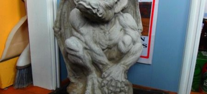

The family
The kids:
gargoyles
The bigger kids (first one's mine, second is my wife's favorite):
gargoyle
gargoyle
My very first gargoyle (just a little fella):
gargoyle
Grampa and not to be messed with:
gargoyle
