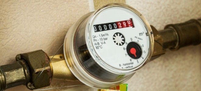

Hi folks,
Any thoughts would be great here. I noticed a leak on my basement floor just below the water meter. Then I noticed there's a very small leak coming from one of the corners of the meter. You can see from the pics below it's a very slow leak, but a leak nonetheless. Not even sure what to ask here besides what should my next step be?
Thanks!

XSleeper - Group Moderator
Well i'd say you need to lookup the brand name of the meter and see if you can find a gasket for it.
John Palatzo - Thread Starter
Thanks, that’s a good place to start. I’ll check that out. Looks like there’s one shutoff valve before the meter and one after the meter, so “maybe” I could replace the gasket myself.
Silly question, but the meter is my responsibility right, not the water company’s?
Correct. I have never seen a water meter that wasn't the homeowner/business owner's problem. The utility's responsibility ends at their shutoff that's buried out by the street.
PJmax - Group Moderator
The water meter is the sole property of the water company. That's why it's sealed.
Call the water company and schedule a replacement.
So I gave the water company (the town) a call today. They said it's their responsibility. They had someone come over in 15 minutes, replaced the black gasket that's the same size as the bottom of the meter, and we were good to go. Amazing how sometimes (maybe 10% of the time) things are just that easy. He said it was good that I noticed it because it was just going to get worse and worse. So here's my public service announcement that if you haven't looked at your water meter in a while, go take a look!
Thanks for the help everyone!
