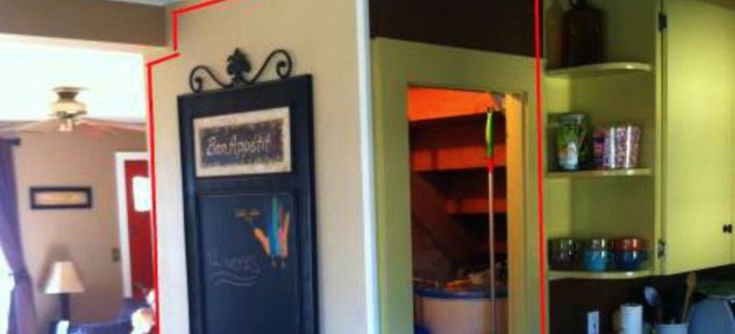

I have a closet between my living room and kitchen. Any reason that you see why I couldn't take this down? I want to take it back to the side of the kitchen counter and then build a door flush to access the water heater. Thanks.

What a funky place/design for a closet. Not being on site, we always recommend the services of a structural engineer to make determinations. With that disclaimer, it appears this closet has load bearing properties. There appears to be a beam type soffit that ends with the closet and needs vertical support.

Thanks for the reply Chandler. When you say "beam" are you referring to the one in the last picture that protrudes from the closet from the left?

Actually I missed the stair landing. So yes, the entire square is load bearing for the landing corners. That's why the closet exists.
