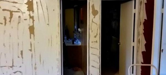

Hi All,
I have a room that has 1/4" faux wood paneling glued and nailed to a painted and textured drywall surface. I have removed the paneling as carefully as possible. But there is extensive damage to the drywall paper. See picture below.
I am going to put a textured surface over all these damaged walls. So I am not that worried about getting a perfectly smooth surface.
I have looked at a lot of YouTube DYI drywall repairs. And it seems to come down to 2 general methods of repair.
1) use something called peel bond(?), or skim coat(?) to glue down, and moisture seal the exposed paper. I do not know about these products. Then add the new wall texture.
2) sand down the paper and edged around the paper, then mud over, dry, sand, mud again, dry, sand, then add the new wall texture.
I live in about 30 miles east of San Fransisco, where is is very warm in the summers 90's+, and down to the low 40's in winter. Forced A/C & Heat.
I am leaning towards method 1.
I would like some additional input. Am I missing something? Additional steps needed? Better products, or methods?
Any help would be most appreciated.
Thanks

Marksr might have different idea but damage doesn't look that bad in picture. Unless not seeing something would paint over with oil base primer to seal drywall and skim coat over that.

Thanks for such a quick reply.
Here are a couple pictures showing the damage looking from close to the wall.
What kind of sealant or primer will hold down the paper? Or should I peel off the loose paper tips, then seal/primer?

When you go to peel off the loose paper, cut it along the perimeter first so you don't just continue to peel the whole wall. Anywhere you have exposed gypsum you have to use either an oil base primer or Zinnser's Gardz to seal the gypsum and prevent further damage.
I'd sand as needed, prime, skim coat the entire wall, sand, touch up the skim coat as/if needed, remove the sanding dust and it should be ready for primer and paint.

Even though you are going to texture the wall, you need to address these blemishes or they will show through on the finished product. Seal with Zinnser Gards which will turn the paper to a hard substance. Any paper that continues to be loose needs to be removed. Flaking paper is a big issue with drywall that has had the surface paper compromised like yours. Then you need to do a light skim coat to blend the blemishes. I would use a setting type joint compound that you mix from a powder. Sand between coats, use a strong light of flashlight and hold it close to the wall so the light shines across the patch. Work it until the blemishes blend better into the wall.
