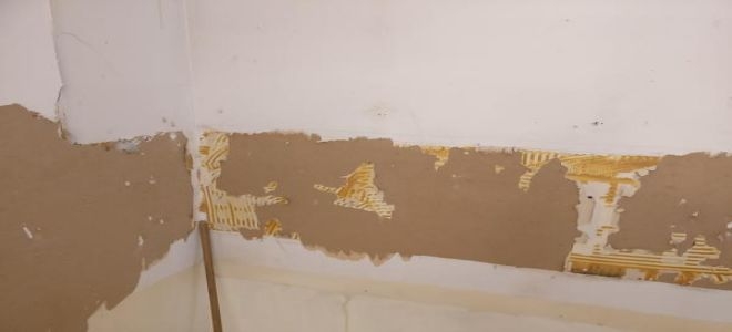

Well, I took the tiles down and obviously there's some damage.
Torn up drywall.
So do you guys still think patching is a good idea or maybe just cutting out some big sheets of drywall and going that route? I'm okay with either way. I'd just like to know what's the most efficient way?
marksr Forum Topic Moderator
In my opinion, skim coating is quicker. You will need to coat bare areas with Gardz or an oil based primer first.
TylerJay Member
Now as for this one piece where the cupboard collapsed and pushed in the side of the drywall, I'm guessing a new cut-out piece of drywall is best?
If it's behind the cabinet, I wouldn't be overly concerned but if it will be visible I'd replace that section (stud to stud).
