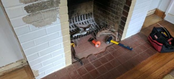

Newbie here taking on a what I was hoping would not be too big a project. My plan is to remove hearth and then tile over it and the brick fireplace.
hearth removal project
Removing the hearth is going to be harder then I thought. Pounding away with a four pound hammer and chisel is not getting me very far and and I can see by the way the pieces are breaking off that it's going to be tough to get this level again.
Tiling over the existing tile was not really an option because I want the new tile to be flush with floor as it is now. Is pounding away the best way to continue or is there something I can rent at HD (rotary hammer, demo hammer?) that will make this job easier?
For fireplace, the white paint is chipping so I assume my options are either to get the paint off before putting on thinset or leave the paint and put cement board on top of it.
Any thoughts on which is better? I'd prefer to go straight to thinset but chipping away at this paint is also slow going. Is there something I can put on it to make it peel off easier? I know it's not lead paint as I'm the idiot who painted it.

Forget the hammer & chisel. Rent a chipping gun. You can buy paint remover to remove the paint. Just be careful when you use it. Wear gloves and safety glasses and make sure that there are no children in the room. Open the windows.

Floor tile will be easy once you get under the tiles they should just pop up.
Are you attempting to take the brick out?
garimh - Thread Starter
I'm attempting to take the brick tiles out of the hearth. But I'm not removing any brick from the fireplace. Just putting up some tile and then a surround.
czizzi - Member
Demo hammer and a tile bit will be the way to go. You can rent them but probably will have to buy the tile bit. Be warned, this creates a TON of dust so, wear a mask, and take precautions with furniture in the room.
If you can plastic off a portion of the room to include a window, set a box fan in the window blowing out, then crack another window somewhere in the house for make up air. Then cut a slit in your plastic. Most of the dust will be directed out the window.
Other precautions are leather gloves as tile shards are very sharp.
Once the main tiles are up, you can pick at any high spots by hand with a hammer and chisel of stiff putty knife.
For the brick, just get the loose material off, choose a good modified thinset that is sticky (Mapei - Ultraflex II) and you should be good to go provided that the brick face is relatively smooth without high or low spots.
