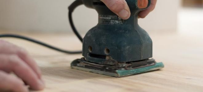

I’m looking for information on how to proceed with resurfacing the floor in the pictures I have attached. I know I have to rent a drum sander and edge sander. Apart from pulling all the flooring up, how can I fix the issues seen in the pictures? We purchased the house 10 years ago and I suspect the previous owner installed the floor himself. Over the years, I think planks have shrunk and I know the middle of the knots have popped out. We are thinking of going to a darker stain before applying the finish coat. Would I be able to get away with a stainable wood filler of some sort to fill the gaps? Your suggestions will be appreciated.

With popped knots, if there is no subfloor, I go below and attach a scrap of wood to the bottom to block off the hole. Leaving the hole open to collect dirt is the easiest. You can also drill out the popped knot to make a nice round hole. Then, soak a wood plug in glue and hammer it in the hole. Sand flush and finish. I've not had great luck with putty-type fillers for popped knots. If you go high tech with epoxy, it can hold but then it won't take stain so it's a color matching problem.

It's easy to get in trouble using a drum sander! It doesn't take much to sand off too much in spots and get a wavy floor. While a good bit slower, a buffer/orbiter-type floor sander is more DIY-friendly.

I am no expert in types of wood, but I have attached a picture of a spare piece I found from when the previous owner installed it. I am looking to buy some more so I can remove pieces where knot holes have popped and refinish it all. The biggest question is staining, as I’m not sure because of the type of wood if stain would take or if I should just add polyurethane and go natural (wife would like a darker color). I will be renting a square sander starting with 32-grit and going up. (Reasons being ease and I’ve seen too many screw-ups with drum sanders.) I did try the fingernail test on a back of a spare piece and it left no impression, so I hope that means it’s a hardwood variety.

I‘ve stripped the floor with a drum and flat orbital sander and just today rented an edge sander. I have a belt sander, orbital palm sander, and a sheet sander, but I’m not sure which would be best and what grit to use.
marksr Forum Topic Moderator
Not sure I understand; the drum sander should have flattened the flooring. The edger is used next to the wall and other places the drum sander won't fit.
