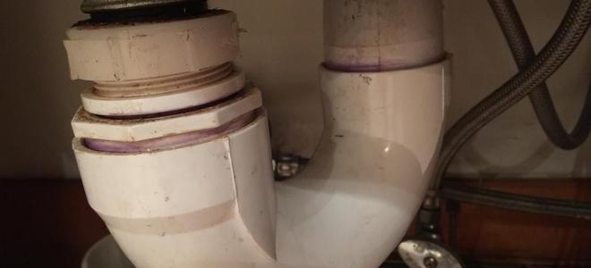

Hello, all. I've tried fixing my clogged kitchen sink via simple methods found via Google and YouTube such as salt, baking soda, vinegar, boiling water, and a plunger. It seems like I was able to plunge it successfully at one point as it drained well right after, but then I thought it would be a good idea to plunge it some more and subsequently the sink clogged to the point it wouldn't drain at all.
I've tried removing the P-trap below the sink, but was unsuccessful. I was able to loosen the inlet on the left side with a wrench. I turned it fully to the left, but was still unable to disconnect the trap. I used a little force to try and pull it off, but was unsuccessful. I feel that I can use some more and remove it, but of course worry about the risk of breaking it.
The right side of the trap has no inlet to unscrew / loosen, which makes me question how it's supposed to come off.
I feel like getting this P-trap off and cleaning it is the solution to my problem, or can at least get me to the point where the sink is at least functional again. Does anybody have any tips on getting this off? What type of trap is this? What tools do I need? Any other tips?
This looked so much easier on YouTube. Clearly, I am definitely far from a handyman. Please help! Thanks in advance.

The connection on the left appears to be a compression fitting, but on the back side it looks solid, at least from what is shown. Is there a similar connection? It may just need to be cut out are refitted with a new P-trap.
Pilot Dane Group Moderator
If the other end of the trap is glued, then you remove it by cutting it off. What size is the pipe coming out of the wall? From your photo, the trap appears oversized.

It seems like there is no screwable inlet on the back side; it appears that it fits flush. Maybe it's glued on? Is cutting it out and refitting it my best bet? Would Drano be effective in fixing this issue? I'm really trying to avoid hiring a plumber for this job.

Skip all the chemical crap. Do what PD and Marq said. You need to cut the pipe and replace it with standard slip nut-type traps. When your traps are off, then a snake into the cut pipe will most likely clear the clog.
Are any other sinks or toilets running slowly? If so, then the clog is much further down the line and you may need to open a clean-out and snake from there.

Can’t tell what the situation is above the "U" on the back. If there is a straight section, then cutting it out and replacing it would be much easier. I'd pick up several drain pieces and visually see what works, but having a compression on both sides will allow for easy removal.
Another thing I noticed—is that a clean-out drain at the bottom of the "U" or something in the background?

From your photo, the trap appears oversized. Most kitchen sink drains and traps are 1 1/2" but your trap appears larger and has a reduction bushing, so I'm guessing it's 2".
If you can cut off the existing and leave at least an inch or two of pipe protruding from the wall, you can glue on a 2" to 1 1/2" DWV trap adapter. This will allow you to use slip couplings and trap, which will make assembling everything very easy and allow you to easily remove the trap in the future.

It appears that it is indeed a size 2. I've added more pictures for reference. Hopefully they're useful. There is a bottom piece, which doesn't seem to be accessible. I've tried pulling at it and unscrewing it, but it's stuck in pretty tight.
