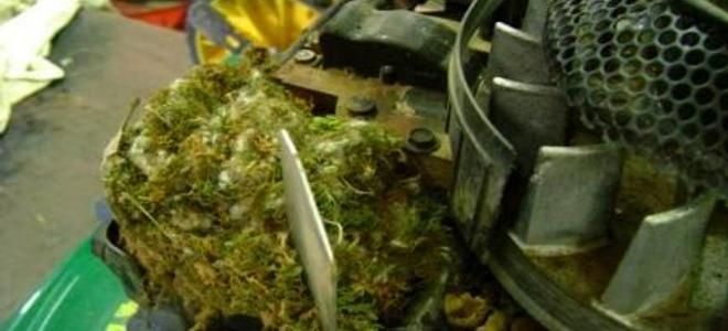

“How do I fix this??? Causes high rev.” Third year in a row for this repair. Do I tell customer to get a cat or poison?? Just thought I’d pass this on. Some days on here you read posts of high revs.

I think the pick-up is too close to the flywheel, not sure. Maybe that's the problem. Other than that, all is normal. Mouser, for sure!

Every year my customer brings this mower to me and yes for three years the same problem. The mouse builds a nest which will not let the gov arm blow away from WOT. So same ole thing. Take the nest out and all is well. Runs great! Yes, he may be getting something marksr. Maybe a piece of cheese - food that is!
