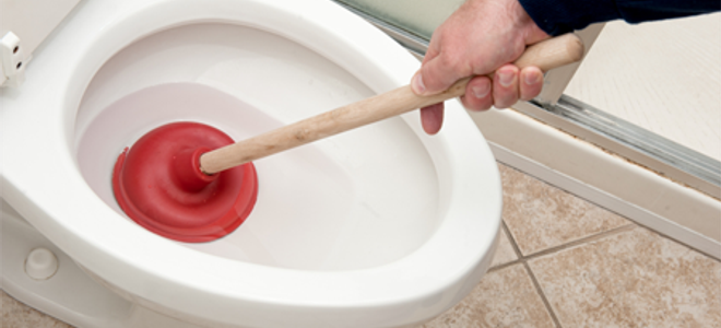

Original Post: Toilet needs frequent plunging
BigGuytinytown Member
Hello, I have a one bedroom apartment and the toilet occasionally needs to be plunged for liquid waste. I did pull it, surprised I couldn't get a snake through the top or bottom of the toilet when it was laying on my bathroom floor. I'm thinking a toy might be stuck in the pipe [from the previous tenet’s kids] but I'm not sure if that is the case or not. The water here is very hard, have to scrub it twice a week to keep it white. Is there a liquid I could put down it to make it so the frequent plunging would go the way of the dodo bird?

joecaption Member
Do you own this apartment?
Tried poring at least a 5 gal. bucket of water down the drain to see if it's the drain not the toilet that's the issue?
There is no magic liquid that's going to remove a solid object from a toilet if that's what it really is. Are you using a toilet auger to snake the toilet?

Your water hardness likely has little to do with the drain problem. In severe cases it can clog the holes under the rim which can affect the quality of flush. It's easy to spot when you flush. If water comes out some holes but not others something may be clogging them. I have also seen drop in tank "blue things" break apart and the chunks can also clog the holes around the rim.
If there is a toy, especially a ball, inside the trap of the toilet replacement is usually the only option. Getting a regular drain snake through a toilet trap can be difficult but if you can't get a toilet snake through that could indicate an obstruction. I take the toilet outside and set it up on a couple bricks so the drain on the bottom is clear of the ground. Take a big bucket of water and quickly pour it into the bowl. Does the toilet flush? Does the water flow through well? If it flushes and the water flows well then I'd focus on the drain pipes before rushing out to buy a new toilet.
Since the toilet is removed get a 5 gallon bucket of water and quickly pour it down the drain pipe in the floor. Does it flow freely? Even if it doesn't back up do you detect a change in tone or sound of how the water goes down the pipe. If it's backing up somewhere down the line you can often hear the pitch of the water sound change.

It sounds like baby wipes. Try to suck them out with a wet vac. If that doesn't work, go to the cleanout in the cellar, if there is one. I removed what seemed to be an entire package of them once. The package said "flushable" WRONG. They were called Kan-do by Proctor & Gamble. I tried to call them & couldn't get through, no surprise there. I started a thread called "No Kan-DO" I hope that P&G is reading this forum.
