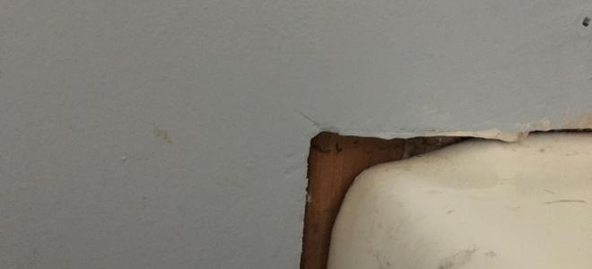

Howdy, I need some advice on how to proceed with a tub shower tile job. I hired a "contractor" to help me with a bathroom remodel, he was supposed to install the tub shower backer board (Hardibacker) and install tile. He disappeared and I have to finish the job.
So, the Hardibacker has a gap around the tub that varies from 1/2 to 7/8". This seems excessive, is it? If so how would I handle filling this gap?
Also, he used paper tape and mud for the Hardibacker joints and screws, some of it is bubbled up and some of the screws are just proud of the board. Should I sand away all that and reapply with fibermesh tape per Hardibackers instructions? It seems like most of the screws are stripped so pulling them tighter probably isn't an option.
For addtl info: the tub is a standard 5' steel/iron tub and was the only original thing left in place for the remodel and is installed right up against the studs. I will be using a combination of 4 1/8" sq and 4 1/8 x 8 1/4" tiles and some glass mosaics as a band or inlay (not decided what the design will be but the tiles are on site already). I don't have mortar or grout yet so advise on those as well please.

Gap as in the hardibacker board was installed above the top edge of the tub crating a gap that varies in size 1/2-7/8", making me concerned that there won't be enough support behind the tile. 1/8-1/4" I could see being ok as that's not so much wider than tile spacing and the bead of silicone would do ok.
this steel/iron tub does not have an upward turned lip to mount it to the studs like some modern tubs I've seen, so there is nothing in this gap except the stud space.

I have seen tubs without an upturned lip leak many times. Even if there is not a full blown leak it's easy for water to wick under caulk that has pulled. It's not the best to enclose for a shower. If you have a basement or crawl space below it's a good idea to go underneath once a year and inspect for water damage. Often it only manifests above when the tub starts to sink or the tile moves when pushed or pulls away from the tub.
The gap between your Hardie Backer and tub is a bit much but a lot depends on the tile you install. A large thick tile can better bridge the gap without support while there is no chance with a penny tile. Where some trouble will come is when you grout. With nothing backing up the joints in that area the grout will push through. The grout in that area may also crack and fall out if hit or treated roughly since it's only sticking to the sides of the tile and may not have great adhesion as most tiles are glazed on the sides.

You can bridge the gap at the tub lip with tile, but major concerns that there is no tile lip on the tub. This makes you rely on caulk as your last defense against water - caulk fails all the time and you have no back up safety net.
The bridge between hardie and drywall needs to be cleaned up if regular joint compound was used. I would then go back with a mesh tape designed for cement board and a setting type compound which is not subject to water erosion like regular joint compound.
Again, your backer can be saved, the issues I have is the non-tile ready tub. What thickness of hardie did he use. If 1/4" then just tear it out as it is not designed for walls.

The tub has the slightest bit of a raised edge along its top, probably enough to keep moisture from going past but certainly not enough for my rowdy 6 year old monsoon baths lol.
I was thinking maybe get some SS finish nails and set them as anchors in the studs in the gap and then run SS wire between them to act as substrate for mortar to fill the gap. Only other idea I had was to take ~4" wide pieces of the Hardibacker and slide wedge them into each stud space of the gap with construction adhesive buttered on each end and inside back edge. Or am I over-thinking this too much?

There is only so much you can do with that tub. It's OK for a tub but not good for a shower or containing heavy splashes. The best thing you can do is give the caulk joint between the tub and tile a thorough inspection once or twice a year. If you find any spots where it seems the caulk has come loose from the tile or tub... replace it with fresh caulk. As Czizzi mentioned the caulk is the main defense against water getting into the wall.

The gaps are normal and nothing to worry about. Just plan your tile layout so a vertical grout line falls well outside that area and the majority of the tile is adhered to the backer board. I see nothing wrong at this point. Enjoy your build.

Ill be removing the mud and tape and the paint if needed. Then using the fiberglass mesh tape with mortgage and mortaring that gap between the tub and hardibacker.

Have you considered running 1/4 round pieces where the wall tile meets the tub? That was the solution I came to when sealing a fairly large gap after I had filled it with thin set. I used adehesive caulk to set the 1/4 round around the tub and then used the same to grout. Caulking the planes between the wall and 1/4 round and along the tub lip gives a pretty good watertight seal. The 1/4 round helps to shed the water into the tub instead of wicking back to the studs. Dal-Tile makes matching 1/4 round tile to the field tile so it becomes inconspicuous.
