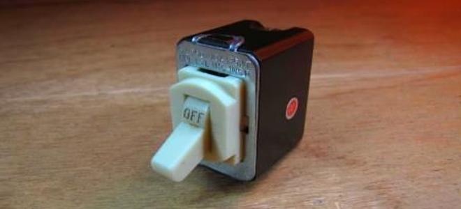

Original Post: How do you install these toggle switches? (Small body, no apparent mounts?)
Nick D. Member
Cleaned a bit of the basement today and unearthed a small stash of 'lectricians goodies. Everything is familiar to me, excepting 5 toggles that I found.

Those mount in snap-in plates for a custom setup. Look up despard devices.
Furd Member
You insert the switch in the yoke and then using a small screwdriver bend the tab (shown on the right in this image) to lock the device in place.
despard device
(Image courtesy of Kyle Design.)

Thanks, guys! I feel stupid now... the name "Despard" brought back some memories.
