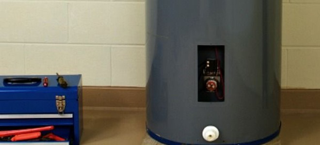

We are going on a 4 week trip, and will be turning off the water. I wanted to know if I should also turn off the electric water heaters. Will they be OK if I don't? There should not be any water flow throughout the house.

Yes, turn off the water heaters. If you turn off the water and somehow it leaks down, the level of the water could possibly fall in the heater, exposing the elements, causing them to burn up. Definitely turn water heaters off.

Have a neighbor you trust? Have them come over and turn the water and heater back on a few hours before you expect to get back home.
I turn mine off when I leave but it's gas and I have hot water within a half hour of getting home.
CasualJoe Member
Mine is gas too and when I am away for more than just a weekend I'll set mine back to pilot and shut off the water too. It's amazing how warm the water will stay with just the pilot. Almost warm enough for a shower.
Pilot Dane Group Moderator
When I leave for long periods I turn off the water heaters, turn off the water and bleed out the pressure by opening an upstairs faucet. It saves the energy of keeping water hot when not home and if a pipe bursts or leaks for whatever reason there won't be massive water damage.
