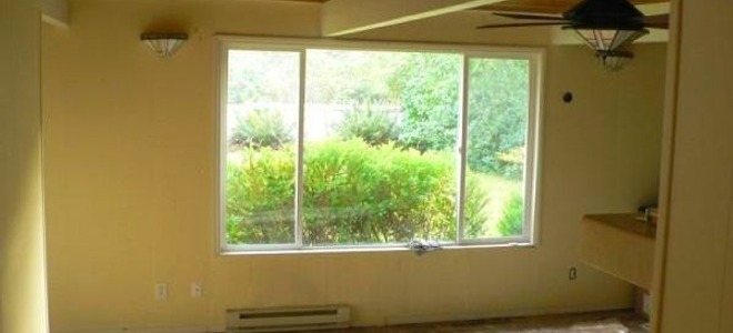

I bought a fixer-upper that turns out to have a sagging ceiling support beam. So my question is how to support this support beam. Connected to that is a question of the flooring. See the photos, but here's the problem:
See that support beam on the ceiling? The one that exits the wall overtop of the big window? There's no support for that support beam!!! The window is now bowed down, there. The window's left slider is difficult to move. You can see it easier on the external photo. In addition, hard to see in the photo, but the siding planks are bulging outward, above the window there -- presumably also because the whole ceiling/roof is sagging down, because the weight on that beam is not supported.

Welcome to the forums! Not sure who the numbnut was that put that beam on top of a window, but that's water over the bridge, so to speak. It must be supported secondarily. The concrete may not be substantial enough for the weight. Normally you would cut a square hole in the existing concrete, dig down to at least 12 inches or below your frost line and pour concrete grout which is harder than concrete. You basically will be pouring a footing for the post. Jack up the beam carefully and measure/cut for a post, at least 6x6, sitting it on your new footing. You can decorate it later. The decorative wood on the underside of the beam may need cutting out so your new post will bear on the beam itself, rather than on 1x lumber laid flat.

In love with that window? Another way but a lot more work, but will look a whole lot better when done, would be to remove that window, and build your support beam into the wall all the way down to the bottom plate.
Then reframe the wall for two windows on either side of where the beam is.
Looks like your siding’s in poor shape anyway so not a lot to lose.

A support post needs a better footer than a long wall - the load is transferred to a small area versus being supported by the length of the wall. Footers are always dug down below the frost line. The frost line is the depth that that the ground is expected to freeze down to during the most extreme winter for that location.

My best guess it that this wasn't a garage, but a patio cover or an attempt at an enclosed patio cover. I also believe someone added this window at some point with no idea what they were doing. They cut into structural members.
I would advise against the post idea. You really have no place to put a post. It can't go near the window, so that would leave it in the middle of the room.
I would open up the drywall a couple of feet on either side of window (floor to ceiling). Post back pictures of open wall, and then get you can get some ideas on how to place a header above window that would support roof (no sagging), and beam in question.

It's also possible the garage door header was removed by some klutz to enable installing a taller window. Your excavation photo indicates a simple garage slab floor, with no footing--quite normal in many parts of the country having shallow frost depths. If it was mine, I'd retrofit a deeper (12"+/-), continuous reinforced concrete footing along the entire length of wall presently lacking one. Fairly simple job, actually, as all of the work could be done from the exterior. Hardest part would be to provide egress for any air trapped between the fresh head of concrete and the underside of the existing slab; otherwise, the air will prevent fluid concrete from filling the void between the vertical soil face and the underside of the slab. Some temporary interior supports would also be needed to prevent the ceiling loads from causing the wall/slab to sag once the soil under the slab is removed. I'd go with two new, smaller windows, with a column between them supporting proper headers over each (for the windows and that naughty beam).

I hate to say it but you'll probably be best off hiring an engineer to evaluate and come up with a plan to implement.
Handyone Forum Topic Moderator
Forget about support posts in room. Follow BridgeMan's advice. You also have a contractor on hand for additional input.
Simply put, the wall where window is now needs to be rebuilt, not a big deal. It also needs footings added, which is a little harder but can be done.
Once you have a plan to replace window wall, you can think about replacing the ceiling beams also.
