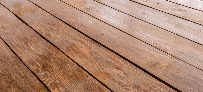

I have an area on a dining room floor (hardwood, tongue and groove) that was badly stained from a leaking shower on the floor above. I've replaced the two strips of hardwood that could not be cleaned up and reused, so I have those two white strips of hardwood and about a 4x8 section of floor to sand down and restain around them. I am looking at a Minwax brochure with a color that should match, but it comes in either a water base or oil base. It also recommends a stain prep product (their brand) and a stainable wood filler. I have used an automotive spot putty on wood before, but always used paint to cover the screw holes. Do you guys like water-based or oil, and would you use the Minwax wood filler or something better?

I prefer oil-based stain over water-based! What type of finish is currently on the floor? Not sure what prep product you are referring to, but hardwoods don't generally need a wood conditioner. Most any hardwood paste should do fine. Sometimes I'll just use colored putty (after stain and first coat of poly).

Oil-based. Oak doesn't need a wood conditioner. Don't use any fillers if you don't have to, since they do not accept stain the same as wood...it will make the filler stand out like a sore thumb.
Try to find oxalic acid (powder/flake) to bleach the stains out of your floor. It can often remove a lot of the unsightly stains from flooring prior to sanding and staining.

I also prefer oil-based, but would use what's been used on the rest of the floor, if you can figure that out.

Oil-based stain is a lot easier to work with than the water-based stains. The odds are that the stain used was oil-based, which can be topcoated with either water-based or oil-based poly. Water-based doesn't change the look of the wood other than to give it a sheen. Oil-based poly will deepen the colors in the wood and amber some as it ages.

10-4 on the oil-based preference. I don't know what they used in 1963 when the house was built—maybe the floor came that way? I have to fill some holes. The flooring that was replaced was badly warped, but I got the ones next to it to flatten out with wood screws, which left some holes to fill. I will try the stain on the Red Oxide body filler—who knows, maybe I am on to something with it? I will look for the oxalic—maybe sold at building supply stores?

They wouldn't have used poly back in '63. Most were lacquer, shellac, or varnish in that era.
I don't know about the red oxide filler, but with the hardwood paste you smear it on, let it dry, and then remove 90% of it when you sand...all prior to applying stain and/or poly.

Poly will wear better than varnish. Hard to say if oil-based poly alone will make it blend as we haven't seen the floor. Which Minwax stain on the chart matches your floor?

The Minwax color is called "natural" (top of the first column in their current brochure). Will polyurethane stain the wood the same way the original varnish did?

I've never seen the point of "natural" stain unless you were to finish with water-based poly. Oil-based poly pretty much gives the same look.
