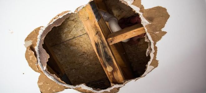

Often, a DIYer must blend old drywall with existing drywall to repair a hole or damage created during another project. Common projects that often lead to a drywall repair are plumbing and electrical repairs or water damage repairs resulting from burst/leaking pipes or compromised roofs. While it may be difficult for a novice DIY enthusiast to produce a seamless drywall patch, the chances of success increase when you institute the same techniques used by professional drywall and home repair contractors.
Step 1 - Remove the Damage
Remove the damaged section of drywall between two existing wall studs. A stud finder is ideal to locate the centers of existing wall studs. Use a utility knife and straight edge or level to score a plumb line on the drywall to be removed so that the cuts fall on the centers of each wall stud. This will provide a solid nailing surface for the side edges of the new drywall.
