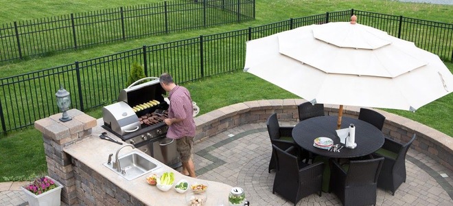

One handy addition to your outdoor kitchen is a microwave oven. It will let you cook things quickly and neatly, and also heat up leftovers. Given the limited room in an outdoor kitchen, fitting a microwave oven into the space and keeping it out of the weather can be a challenge. Those aren’t the only factors you need to consider with a microwave in your outdoor kitchen, however.
Step 1 - Fit
There are different sizes of microwave ovens, and a small one can easily squeeze into a small area of the countertop of your outdoor kitchen. If counter space is at a premium, you can put other kitchen appliances on top of the microwave oven. Go for the smallest possible microwave you can find. Modern ovens should still be powerful enough to handle all your needs.
