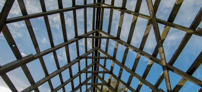

Adding a bird's mouth to a roof rafter should be the last step in the completion of your rafter but is the most difficult to get right.
This cut allows the rafter to sit squarely on the top plate and when cut right gives a solid foundation for attaching the rafter to the wall.
