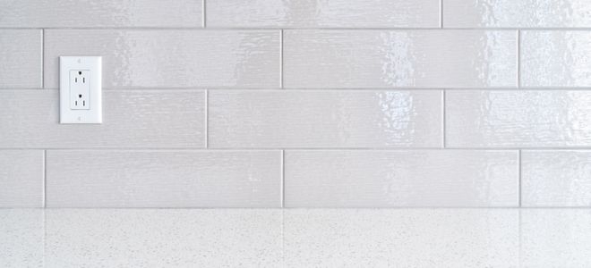

Glass tile can serve as an excellent backsplash for your kitchen when used effectively. Installing individual glass tiles can pose many interesting problems in many interesting ways, but none are more challenging than installing these tiles around wall outlets. In order to complete this project effectively, you will need to follow the steps below carefully and in order. If done correctly, you will be rewarded with an attractive and functional backsplash that you can be proud to say you did-it-yourself.

Measure Wall Outlets
Once you have installed tiles across the wall everywhere but surrounding the wall outlets, you will need to carefully measure the outlets themselves. Outlets can come in irregular shapes, which is why it is important to measure them, but as a general rule, most outlets will be roughly two inches by four inches.
