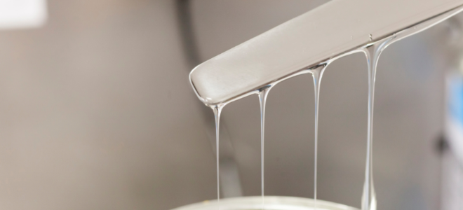

resin dripping from a stir stick

After adding the first layer of resin, glass mat and resin, roll over the surface with a dowel rod to remove air bubbles. For best results, allow the first layer of resin and mat to cure for 2 to 4 hours before adding the next layer. The surface should be hard, but sticky.
mixing resin
Use a Fresh Batch of Resin
Apply freshly mixed resin for the second coat. Any leftover resin from the first layer will have hardened too much to use again.
Resin, Mat, Resin
Spread resin first, before adding the glass mat, and after, making a sandwich with the resin as the bread and the mat ais the meat. Spread resin very slowly to ensure more control and eliminate messiness. After spreading on a layer of the resin, press on the glass mat, pressing down gently with your fingers. Spread on more resin and roll out any air bubbles with a roller or dowel rod.
