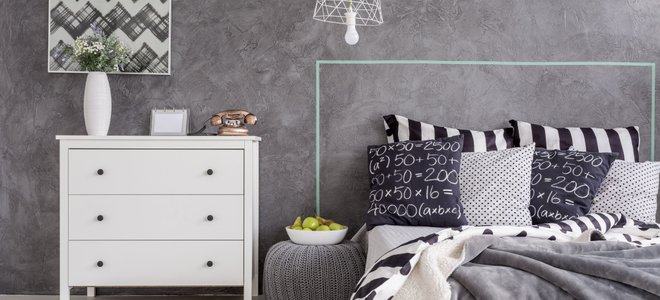

A bedroom with Venetian plaster walls.

A painting technique that homeowners are starting to use more is the faux Venetian plaster technique. This is a way of painting that uses a trowel and a thicker paint called Venetian plaster. It gives the wall a marble or stone-like appearance. As the light hits the surface of the plaster it gives off a very glassy, smooth appearance. Applying the faux Venetian plaster to a tile wall is very easy to do, but it does require some time and attention to detail.
