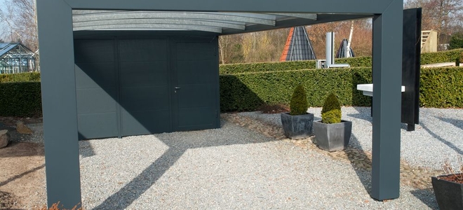

How to Anchor a Metal Carport
A carport.
