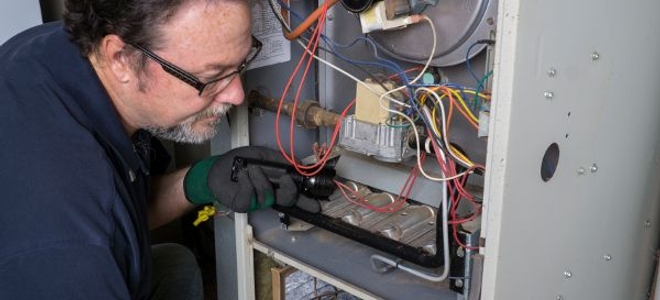

A repairman working on a furnace.

First do a visual check around the furnace itself for obvious signs that it needs replacing. Check for rust or corrosion either on the inside or on the outside of the furnace. Are there any cracks? Take a look at the flame—is it a steady blue flame with no gaps? A yellow flame suggests that the furnace is not burning the fuel correctly.
How often does the furnace turn off and on? If it seems to be cycling more than usual, you might only have to change the filter. If that doesn’t work, have it inspected by a professional you trust.
How does the furnace sound? If it is becoming noisier than usual, have it checked. If your furnace is the right size for your home, you should barely notice when it is on.
