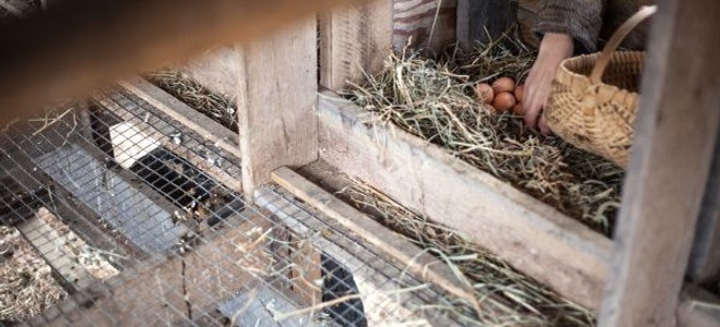

Chickens will lay their eggs almost anywhere, but they prefer to have a cozy, private area. Providing nesting boxes for them meets their needs, and is also a good way to ensure that you won't be spending valuable time searching for eggs. Nesting boxes come in a variety of shapes and sizes.
They can be made from many different materials, and some chicken keepers even repurpose items like milk crates and cat litter boxes. However, the most important thing to remember when building a nesting box is size.
Each nesting area should be at least 12 inches square so the hens will have ample room to move around and lay their eggs. Making them larger, maybe up to 18 inches square, is fine as long as there is enough room in your coop for them.
Another good idea, although not completely necessary, is to make sure that the top of the nesting box is slanted or otherwise prevents the chickens from roosting on top of them. Wherever chickens roost they leave messy droppings that make for an unsightly nesting area.
The design detailed below is made by using 1/2 inch plywood to create three separate nesting boxes in one structure. Each nesting area is a little over 15 inches deep, providing plenty of room for a hen of any size to move around.
This type of nesting box can be securely fastened to the coop wall or placed on a base made of cinder blocks or wood; I fastened mine to an old saw horse and that worked quite nicely.
Keep in mind that if it's fairly high off the floor, the chickens might need a ramp or some other way to easily access the nest boxes. I placed an old crate in front of mine and the hens can jump from the crate to the roost along the front of the structure.
There should be one nesting box for every two to five hens. This design would be ideal for anywhere from six to 15 hens. The nesting areas should be filled with pine wood shavings, straw, or some other similar bedding material.
The hens will form a nest and begin laying in the boxes usually with no guidance. If they do continue to lay outside of the nesting box, simply gather the eggs and place them in the boxes to encourage them to lay in the designated area. It shouldn't take long before they catch on and lay in the nesting box every time.
