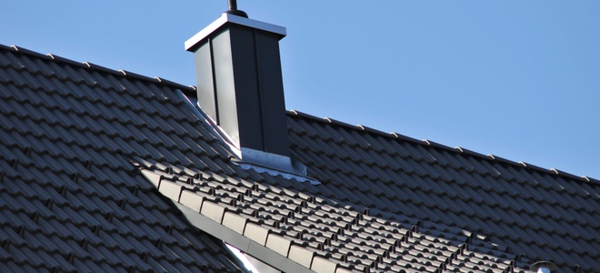

A chimney cap can be an essential part of your home because it prevents animals, leaves and debris from falling into your chimney. Some of these units can actually add drama and aesthetic appeal to a chimney, and others are just made to work well. There are a few different varieties of chimney caps out there, depending on the flute style of your unit. Try to adjust this guide according to your situation. This is made for square or rectangular units, but you can adjust to suit round ones. For the basics behind chimney caps, however, read the guide below.
Step 1 - Measure for Your Chimney Cap
A chimney cap is basically a metal base that sits along the rim of your chimney, topped with a mesh box and a metal cap above that. To plan out the construction of your cap, first measure the edges of the chimney top. You will want the adhere the cap o this rim so measure how long it is on each side and how thick it is. Make not of those measurements.
