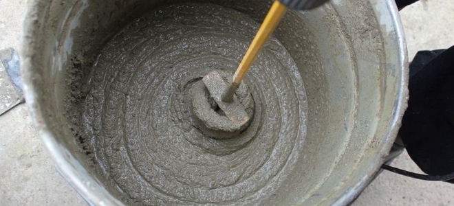

Step 4 - Pour the Footing
Mix the concrete according to your calculations. Do not mix more than needed to fill the hole up to the nails at this time. That is your actual footing and it must be poured separately first, before the permanent concrete setting can be added. Shovel or pour the concrete into the hole, but be careful not to cave in the sides. Push the wire mesh down into the concrete, approximately halfway to the bottom. The surface should be finished smooth, but not slick. Use the nails as a guide for the finish depth, with them barely above the top of the footing. However, these nails are only a guide, so use a torpedo level to make the footing as level as possible. Allow a footing to cure for at least 48 hours before setting the column.
