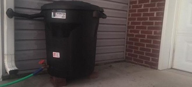

An elevated rain barrel.
Pick an area that is level and can support the weight of a full container. If the area is not level, you can grade it using a rake or shovel. Your system will be less efficient if it isn't level, or might not function at all. The kit will require that it be placed between 6” and 28” from the source.
It's a good idea to use an elevated surface such as a platform, which is something you can make yourself. This rain barrel in the photos is sitting on top of pavers stacked two high. This is also a way you can level out where your container will be sitting. The benefits of having it higher up are that hooking up your hose will be easier and there will be more water pressure.

Now, you have a system that will help save the environment and your wallet!
