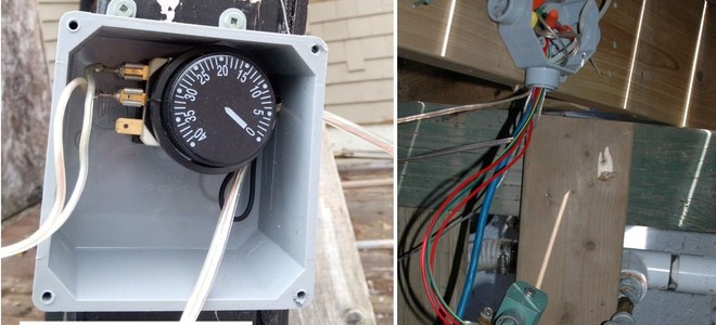

Fig. 6&7- Temperature Control
Step 5 - Glaze the Panel
Another thing with solar panels is that they are sensitive to the ambient temperature around them. If it gets cooler out, whatever warmth was gathered in the pool all day will drop as long as the water runs through the solar panel. If there is a breeze, the wind passing over the pipes will also contribute to a significant heat loss. This can be corrected by glazing the solar panel.
This is done by covering the box with a heavy gauge clear plastic or vinyl thus creating a chamber for the pipe layout (Fig 5). A Temperature Control Switch Thermostat (Fig. 6) is then added to the solar panel to deactivate an N/C (normally closed) solenoid valve (Fig 7) installed along the line running to the solar panel cutting the water flow.
This will ensure that when the water in the solar panel cools down, the flow is stopped. This is where the benefits of solar heat panels are really appreciated.
