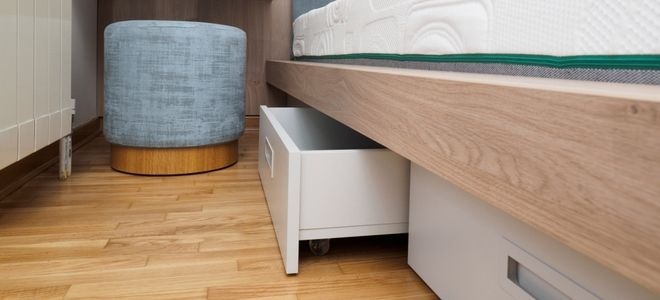

Step 1 - Cut the Wood
The best way to create a twin captains bed is get the measurements off of the twin mattress you will be using. Use the tape measure to measure the length and width of the mattress. Use these measurements to cut the three sheets of plywood to size the 2x4 also to size. You will want two pieces of 2x4 cut to the width and length. Working with the dressers is a bit more difficult. Remove the drawers and the top of the unit.
You will be able to see inside and where the slide rails are located inside. Use the ruler and pencil to mark each section of the dresser that the drawers slide into. Carefully cut the dresser in sections using the lines as a guide. Place the level along the cut lines and make sure they are true and trim as needed. If the drawers have a lip, then strip the lip off so that it is even.
Step 2 - Base
Stack the two pieces of plywood and nail them together. Start with a nail at each corner then several more nails along the edges. This offers a lot of support and strength for the base. With the stacked plywood resting on a flat area, place one of the 2x4 flush against the appropriate side.
The excess board that is taller than the plywood is the lip of the frame and holds the mattress in place. Nail the first 2x4 to the plywood and repeat with the remaining 2x4. Sand down the cut edges and install one corner bracket at each corner inside the base. Add a few drops of wood glue at each nail hole. Once dry, sand down any excess.
