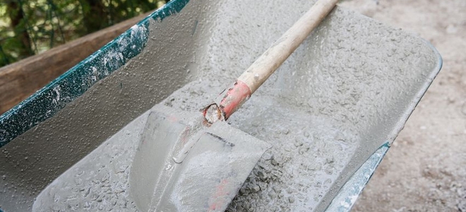

Most modern water-storage tanks for individual homeowners are made of plastic and can be expensive to purchase and ship. For those looking for some savings on a tank, or if you don’t have the money to pay full price, you can build a concrete water-storage tank. These do-it-yourself tanks are not only cheaper, but also they often last longer than their plastic competition.
