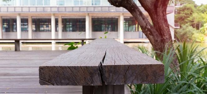

How to Build an Outdoor Bench
The profile of a rustic wood bench next to a tree.
