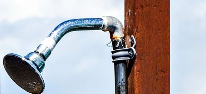

Step 3 - Run the Plumbing
Drill a one-inch diameter hole through the base of the post just a few inches above the ground (the hole should align with the corner of the pad). Pass an 8-inch by 1/2-inch galvanized nipple through the hole and thread an elbow onto the end by the paver pad. Thread a 36-inch piece of galvanized pipe into the other side of the elbow; then thread a "straight" ball valve onto the end of it and another 36-inch section of pipe above that.
How to Build an Outdoor Shower
Secure the pipe to the timber with a couple of pipe hangers so that it is plumb and centered on the landscape timber. Thread an elbow and a short nipple onto the top of the pipe so it faces the pad and then attaches the showerhead. Finally, thread a 1/2-inch pipe to a 3/4-inch female hose thread adapter to the other end of the 8-inch nipple at the base of the posts. Connect a garden hose to the adapter for three-season water supply. Use pipe sealant tape on all the threaded pipe connections.
