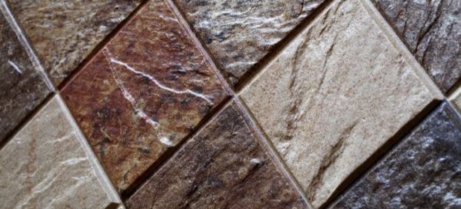

Tile countertops add a sturdy and easy-to-clean surface to any kitchen or bathroom. Tiles are very attractive and come in a wide variety of designs and styles. Installing a tile countertop yourself is a great DIY project. Follow these steps to build and install tile countertops.
