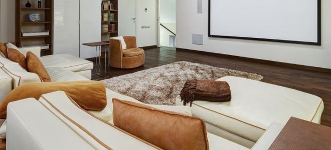

How to Build Home Theater Seating
home theater with large, comfy seats

As home theater systems have become increasingly more popular, so has home theater seating. Stadium-like home theater seating provides an unobstructed view for everyone who is watching television.
