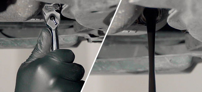

Step 4 - Remove the Oil
Begin by unscrewing the oil cap under the hood of your car. This helps the oil flow better out of the pan. Then, locate the oil pan underneath the car. Check the owner’s manual if you have trouble identifying where the oil is stored. The pan will have a plug that is used to drain out the oil. Position your oil catch container under the plug and keep your funnel nearby. Find a box end wrench that fits the plug and loosen it. It usually takes a few minutes before all the oil is drained.
