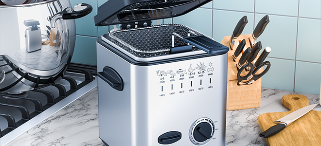

It is not difficult to clean a deep fryer. Deep fryers are a common kitchen appliance, continuously exposed to grime collected from frying different foods. Deep fryers need to be cleaned thoroughly to ensure that the grime doesn’t gain a permanent foothold. Deep fryers cannot be properly cleaned using a dishwasher. The mechanic movement of water in a dishwasher doesn’t have enough pressure to dislodge the thick, oily crusts and the electrical components should not be exposed to water.
