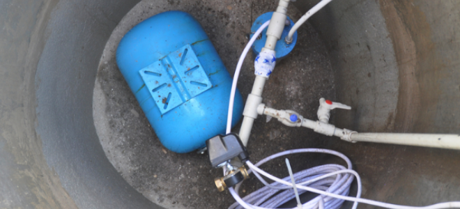

In order to keep adequate pressure in a home with well water, a well pressure tank is used. This well pressure tank is situated on the outside of the pump and stores water that is under pressure. When a faucet is turned in the home, the water is then pushed into the pipes because of the pressure that is built up. Like most mechanical items, the well pressure tank does need to be cleaned and maintained on a regular basis. Here are some steps to take to complete this project yourself.

Attach the garden hose to the drain at the bottom of the tank. It is usually located on the bottom edge of the tank. Simply attach the hose to the drain by screwing it onto the faucet-like outlet. With the hose on the drain and the other end leading into a bucket or out a door, open the valve. The water should begin to immediately drain from the tank.

Located at the top of your well pressure tank is the air regulator that shows how much pressure is in the tank. This can be removed with the use of a pair of adjustable pliers. Carefully remove it so that you do not damage it.
