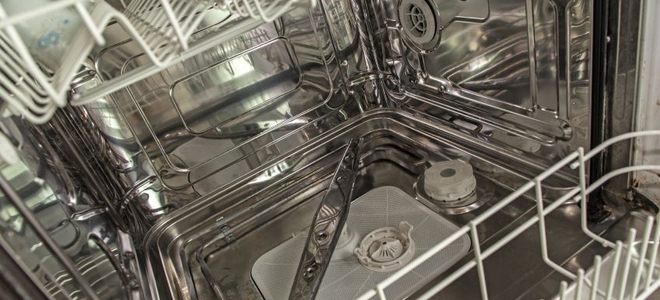

Step 5 - Dishwasher Repair
dishwasher door ajar
After cleaning rust spots from your cutlery, you will want to repair the source of the problem in your dishwasher so they won’t reappear. Remove the dish racks from your dishwasher so you can inspect them in bright light on your counter. Look for places where the protective plastic coating has come off the metal bars. These will often be the focal points for rust. Using steel wool, scrape away any rust until you can see the clean metal underneath. Cover the exposed metal with liquid plastic (available at most hardware stores), allowing the plastic coating to dry overnight before replacing the rack in your dishwasher.
If you can’t find any rust on your dishwasher rack, you will need to look further inside the machine for the source of your rust spot problems. Use a flashlight to look at the hard-to-reach corners inside your dishwasher. Take the small removable parts out and inspect them carefully, removing any rust with steel wool and liquid plastic as you did for the dish racks. Some parts are not covered with liquid plastic and may need to be replaced.
